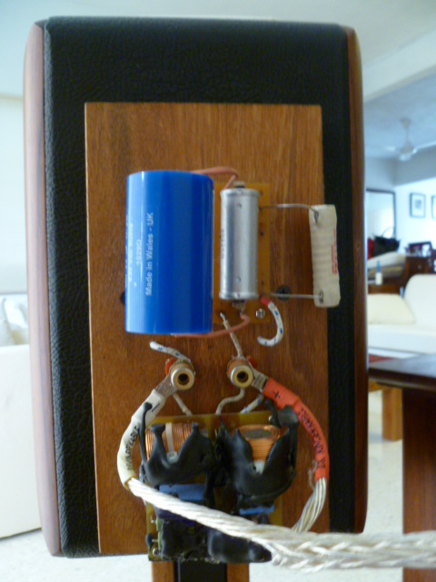

This is my modded crossover of my speakers.
Only the components of the tweeter circuit (top section) has been changed.
These include the capacitor and the resistor.
The woofer circuit (the bottom part with the black stuff) is untouched.
The crossover is now on the outside on the back of the speaker.
The internal wiring too has been changed.
Overall the mod has elevated the speakers to a much higher level of performance.

Yes, only the tweeter circuit components were changed. It was just a simple swap of components of the same value with those of the original.
There isn't any need to redesign the circuit or recalculate any component value. Just changed the components for better ones, that's all.
Measurements were made with the ear-o-meter, ie no measurements of the audio spectrum.
The big blue capacitor in the photo is a Clarity Cap MR, bypassed with a Russian teflon cap (the silver color) while the resistor (white color) is a Mundorf.
Go to this website to read about the choice of capacitors -
http://www.humblehomemadehifi.com/Cap.html

sph wrote:This is my modded crossover of my speakers.
Very rare branded stuffs are moded this way ! Kudos to your effort.
For the finishing touches, may I propose you buy those key chain wooden boxes so you can house the crossover into their new home.
Of course you'll need to invest in male + female banana connectors and make new umbilical cords but heck it'll look awesome.
cheers.

Post by sph on Mon Mar 28, 2011 8:54 pm
Wikin,
I haven't got down to making a housing for the x-over. I would prefer to use a thick wooden base (like presently), but your idea of using a key box is worth considering if I can find something nice and solid.
Mmmm .... you've got a keen eye to recognize the brand of my speaker.
Adrian4454,
I can imagine the improvement to your Epos with the cap change. The Bennics are anemic! I have not tried the Auricap, but I'm sure they are very good too. How much is the 2.2uf Auricap?
Initially, I used a Mundorf Supreme. It was good. Then I read about the cap test in Humble Homemade Hifi website and decided to try the ClarityCap MR as it was well rated, though it cost much more. But it was well worth the extra $$.
Is that all there is in the Epos x-over? Just one cap and one resistor? No inductor? Very simple indeed.

Post by sph on Tue Mar 29, 2011 9:47 am
Adrian4454,
The higher voltage spec of the cap is better for the speakers.
The ClarityCap MR comes in 630V.
I ordered the caps from Madisound, delivered to a US address as I frequently travel there. Saves me on the postage.
Yes, the Epos circuit will save you the itchy fingers to do any further mod except to perhaps use other caps to experiment with.
Did you try using a small value cap like the Vishay MKP 1837 to bypass the Auricap? This is suppose the clear up the sound further. It doesn't cost much. Can order from RS.
I placed the x-over on the outside as it will be easier to do mods or to experiment with other caps in the future, besides isolating the caps from internal resonance in the cabinet.
I am in the process of experimenting with some hook-up wires for the drivers, especially the woofer. At the moment I am using silver coated ones, but I was recommended some thick copper ones. No harm trying.

So, the easiest and foolproof way is to use the exact value (+- a little if exact value can't be found) component. This saves the headache of all the complicated calculations.
Adrian,
The bypass is done by paralleling the Auricap itself. The Vishay 1837 is a 0.01uf cap.
It's available from RS for peanuts.
http://malaysia.rs-online.com/web/search/searchBrowseAction.html?method=getProduct&R=1666421
If you use the higher end caps I'm sure you will find more improvement to your speaker. The Mundorf M-Cap Supreme Silver/Gold/Oil is very well rated but it cost quite a fair bit.
After I upgraded from the Mundorf Supreme to the ClarityCap MR, greater micro details could be heard. The brushing of cymbals could now be distinguished easily.
Yes, I admit that I do have itchy fingers, but not that severe.
The capacitor change is easily the most significant improvement to my speakers. For those who are not very confident of carrying out the mod, take your time to Google it on the web and read the positive comments from those who have done the mod.
Find out more about the various speakers that have been modded. That's what I did before I jumped in to do surgery om my Sonus Faber (Yes, Wikin, you guessed it). Then with a little courage, take a screwdriver and have a look at the x-over inside. One step at a time ....
Like Wikin has suggested, the next step is to give the external x-over a nice housing. I think it deserves it.

Post by sph on Tue Mar 29, 2011 9:57 pm
The ClarityCap MR cost me USD55 each while the Mundorf resistors were USD2.50 each. That totaled up to USD115. It was well spent. Labour was free.
For the price list of the components of various value go to the link below -
http://www.partsconnexion.com/
https://www.madisound.com/about/capacitors.php

Post by sss333 on Mon Apr 04, 2011 12:54 pm
some sharing:
If your original cap is film cap, then normally you can just plug in film cap with same value of different brand.
But if your original cap is bipolar ecap (alcap, bennic bipolar) and so on, then u shall measure the value, because the actual value normally larger than the indicated value. for example a 4uf can read 4.5uf and so on. u might shift the cross over point if u don't measure it.
Besides, some cap may have better transien (louder) such as OIMP, then might need to adjust the value of the resistor to achieve the balance.
Most challenging is when you change the inductor from ferite core/air core wire type to foil type. Because the frequency response of this 2 type is difference, u may need equipment to check otherwise it may sound worse then any improvement.
All the best!!

Post by sss333 on Mon Apr 04, 2011 12:59 pm
Additional info:
as noodle said, the direction of cap also will afftect. 1 directtion can give you more exciting but fatigue sound, the other can give you more relax and comfortable sound.
sss333

Post by adrian4454 on Mon Apr 04, 2011 1:19 pm
You always need to check very carefully on what you will be buying. Auricap does have polarity indication. It can be on the sleeve for the lead, or the lead that's shorter and another is longer. I follow that closely when doing mine, eventhough it is run in serial.

Post by sss333 on Mon Apr 04, 2011 1:55 pm
For power supply and crossover, most will recommend outer foil to ground/output.
But for signal couple is normally opposite. outer foil at input.
Below are some info, correct me if i'm wrong.
1) auricap- balck = outer foil (O-F)
2) Jensen, ampohm & audionote - the line is O-F
3) VCAP- Green is outer
4) mundorf- no indication (octave got put a marking), Suspect O-F on the word M.
5) duelund- use stack foil method, so both lead should be same.
sss333

Post by 7810sam on Mon Apr 04, 2011 10:38 pm
Hi sss333,
You good on cap and inductor. From my experience, My very old Klipsch speaker use film oil filled cap brand aerovox thought it will sound better with this expensive ampohm dry cap but at the end tak boleh pakai at all. Could not find the exact replacement. At last look for something physically similar, guess what, the cap use on aircond motor, brand genteq 2uf oil filled. After changing all the cap, the speaker sing again.
Before this, I was trying to mod the cross over by changing the value but to no avail, ended revert back to ori with new same type/value of cap.
Any idea how to identify the outer foil for this type of cap?

Post by sss333 on Tue Apr 05, 2011 1:02 pm
If u have OSK, then u can test out. Go visit jimmy auw's wedsite, he had done the test if not mistaken.
http://jimmyauw.com/2010/04/24/observing-inner-and-outer-foil-of-some-popular-capacitors/

Post by noodle88 on Tue Apr 05, 2011 1:30 pm
7810sam wrote:Any idea how to identify the outer foil for this type of cap?
hi 7810sam, i can help u to find out the outer foil of caps.
How? using test equipment or by indication?

Post by noodle88 on Wed Apr 06, 2011 9:07 am
Will use a ac voltmeter.
